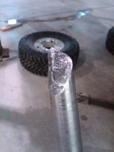

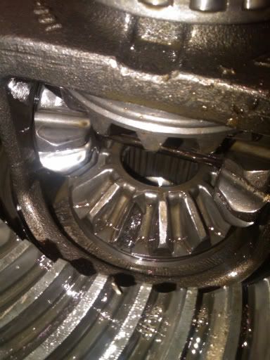

Got a few pics at the shop this afternoon...
Root cause of the failure... HOW on earth did this happen I have noooooo idea. This is the stub shaft that broke. This thing is BEEFY so this really is a major failure......
Diff on the bench! Broken stub shaft is sitting on top of the diff. You can tell that shaft is damn thick!! I will be wondering forever how this could have happened.....
Tooth is gone!
Me and the mechanic both agreed this broken stub shaft is a head scratcher. That shaft split apart and sent chunks into the diff, and of course that chewed up every damn thing inside of it <img src='http://www.canadianhummerclub.com/forum ... ey-013.gif' class='bbc_emoticon' alt=':wtf:' /> Barely did anything to the H3 all day, then it just let go... and this the result! Just chalk this one up to fluke/bad luck....

My hunch would be that there was a defect during the manufacturing process so it may have had a weak spot (Or obviously had a weak spot) as that looks to be about an inch and a half thick.... that doesn't just shear in half for no reason..
I wonder if they used recycled metal? I'm not a metallurgist or what ever those guys are called but it looks awful funny to me...
