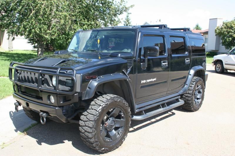

Im not gonna lie, My H2 is a pavement princess....
But i really want big mudders on her and I dont think mud grapplers any bigger that 35's will work without going up.
Ive got my eye on a fabtech 6" lift and I want to try 40" mudgrapplers with it. If it wont fit in the garadge then I can do the gobi roof rack as well to achieve the look im going for.
I assume i will have to change the gears as well? And i have a supercharger so now im worried I will cook the tranny?
I dont do many long hauls with her other than a few hrs with my boat and she never sees the mud so I shouldnt need to go to aggressive with the 4x4 gear will i?
And advice or info would be greatly appreciated as this is my first time going up.... My last few rides were dropped with bags :)
Here she is now

Based on the picture that you have posted, what size are the wheels and tires ?

18" rims and 35x13.5 tires its stock height just leveled
